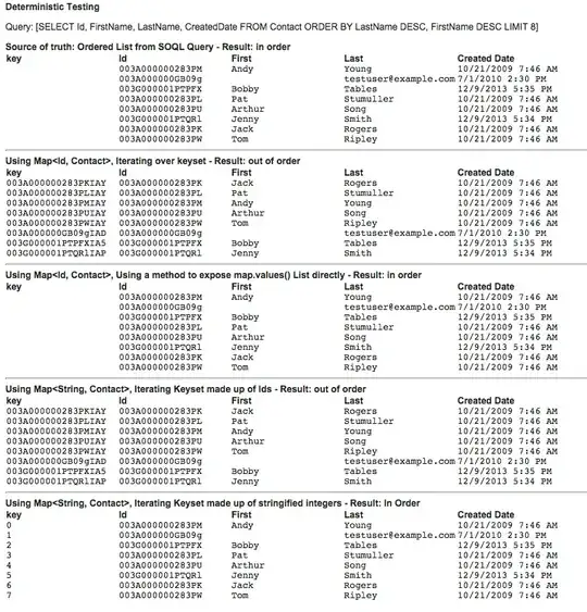

I wasn't satisfied with the accepted answer, specifically relating to the VisualForce aspect of it, so I performed some additional testing on this critical fix with regard to VF.
What I learned is that when a VF iterator (apex:pageBlockTable, apex:repeat, etc.) is used against a Map, one of its undescribed actions is to sort the keys. This completely negates the benefits of a deterministic order being present.
In this test, I queried for 8 contact records and sorted them by Last & First in descending order into a List<Contact> as the "source of truth" and then iterated the list and populated a few maps to be shown on-screen.
The results rendered on-screen using an iterator that did not leverage the keyset were displayed in the expected order. An iterator that used the keyset produced "undesired" results.
While testing, I attempted to use a complex type for the key and received an enlightening error message from the VF runtime that: This map cannot be used in an iteration because the keys cannot be sorted. (aha!) In an attempt to get around this behavior I implemented the Comparable interface on the apex class to allow sorting of the complex type key - which got past the first error but still did not work and threw another unrelated show-stopping VF error. (So, I gave up.)
In the end, while the order may be deterministic in Apex, when used with a VisualForce iterator - the keys will be sorted on your behalf and beyond your control.
(On further consideration, I wonder if the sorting is implemented within the .keyset() method on the Map class and I am falsely accusing the VF of dirty deeds.)
Test Results Image
Test Results
Controller

<apex:page controller="DeterministicCollectionController">
<style>
    table.test th { width: 12em; }
    table.test td { font-family: monospace; }
</style>
<h1>Deterministic Testing</h1><br />
<p>Query: [SELECT Id, FirstName, LastName, CreatedDate FROM Contact ORDER BY LastName DESC, FirstName DESC LIMIT 8]</p>
<h2>Source of truth: Ordered List from SOQL Query - Result: IN ORDER</h2>
<table class="test">
    <tr>
        <th>key</th><th>Id</th><th>First</th><th>Last</th><th>Created Date</th>
    </tr>
    <apex:repeat value="{!contactsSortedByLastFirst}" var="contact">
    <tr>
        <td>&nbsp;</td>
        <td>
            <apex:outputField value="{!contact.Id}" />
        </td>
        <td>
            <apex:outputField value="{!contact.FirstName}" />
        </td>
        <td>
            <apex:outputField value="{!contact.LastName}" />
        </td>
        <td>
            <apex:outputField value="{!contact.CreatedDate}" />
        </td>
    </tr>
</apex:repeat>
</table>
<hr />
<h2>Using Map&lt;Id, Contact&gt;, Iterating over keyset - Result: OUT OF ORDER</h2>
    <tr>
    </tr>
    <apex:repeat value="{!orderedContactMap}" var="contactId">
    <tr>
        <td>{!contactId}</td>
        <td>
            <apex:outputField value="{!orderedContactMap[contactId].Id}" />
        </td>
        <td>
            <apex:outputField value="{!orderedContactMap[contactId].FirstName}" />
        </td>
        <td>
            <apex:outputField value="{!orderedContactMap[contactId].LastName}" />
        </td>
        <td>
            <apex:outputField value="{!orderedContactMap[contactId].CreatedDate}" />
        </td>
    </tr>
</apex:repeat>
</table>
<hr />
<h2>Using Map&lt;Id, Contact&gt;, Using a method to expose map.values() List directly - Result: IN ORDER</h2>
    <tr>
    </tr>
    <apex:repeat value="{!orderedContactMapValues}" var="contact">
    <tr>
        <td>&nbsp;</td>
        <td>
        </td>
        <td>
        </td>
        <td>
        </td>
        <td>
        </td>
    </tr>
</apex:repeat>
</table>
<hr />
<h2>Using Map&lt;String, Contact&gt;, Iterating Keyset made up of Ids - Result: OUT OF ORDER</h2>
    <tr>
    </tr>
    <apex:repeat value="{!orderedContactMapAsString}" var="contactId">
    <tr>
        <td>
            <apex:outputField value="{!orderedContactMapAsString[contactId].Id}" />
        </td>
        <td>
            <apex:outputField value="{!orderedContactMapAsString[contactId].FirstName}" />
        </td>
        <td>
            <apex:outputField value="{!orderedContactMapAsString[contactId].LastName}" />
        </td>
        <td>
            <apex:outputField value="{!orderedContactMapAsString[contactId].CreatedDate}" />
        </td>
    </tr>
</apex:repeat>
</table>
<hr />
<h2>Using Map&lt;String, Contact&gt;, Iterating Keyset made up of stringified integers - Result: IN ORDER</h2>
    <tr>
    </tr>
    <apex:repeat value="{!orderedContactMapAsAnIntegerString}" var="key">
    <tr>
        <td>{!key}</td>
        <td>
            <apex:outputField value="{!orderedContactMapAsAnIntegerString[key].Id}" />
        </td>
        <td>
            <apex:outputField value="{!orderedContactMapAsAnIntegerString[key].FirstName}" />
        </td>
        <td>
            <apex:outputField value="{!orderedContactMapAsAnIntegerString[key].LastName}" />
        </td>
        <td>
            <apex:outputField value="{!orderedContactMapAsAnIntegerString[key].CreatedDate}" />
        </td>
    </tr>
</apex:repeat>
</table>
<hr />
<h2>Using Map&lt;WrapperClass, Contact&gt;, Iterating Keyset made up of Apex Class - Result: In Order</h2>
    <tr>
    </tr>
    <apex:repeat value="{!orderedContactMapWrappers}" var="key">
    <tr>
        <td>{!key}</td>
        <td>
            <apex:outputField value="{!orderedContactMapWrappers[key].Id}" />
        </td>
        <td>
            <apex:outputField value="{!orderedContactMapWrappers[key].FirstName}" />
        </td>
        <td>
            <apex:outputField value="{!orderedContactMapWrappers[key].LastName}" />
        </td>
        <td>
            <apex:outputField value="{!orderedContactMapWrappers[key].CreatedDate}" />
        </td>
    </tr>
</apex:repeat>
</table>
</apex:page>

            i++;
        i = 0;
        for(string stringMapVal : stringMap.values()){
            string stringListVal = stringList[i];
            system.assertEquals(stringListVal,stringMapVal);
            i++;
I also put together a Visualforce page and checked the output manually. Page:
<apex:page showHeader="true" sidebar="true" controller="DeterministicController">
    List:<br/>
    <apex:repeat value="{!stringList}" var="v" >
        {!v}
    </apex:repeat>
    <br/><br/>
    Map.values():<br/>
    <apex:repeat value="{!stringMapValues}" var="v" >
        {!v}
    </apex:repeat>
    <br/><br/>
    Map.keys():<br/>
    <apex:repeat value="{!stringMapKeys}" var="v" >
        {!v}
    </apex:repeat>
    <br/><br/>
    Set:<br/>
    <apex:repeat value="{!stringSet}" var="v">
        {!v}
    </apex:repeat>
</apex:page>
Controller:
public with sharing class DeterministicController {
    public List<string> stringList {get;set;}
    public Map<string,string> stringMap {get;set;}
    public Set<string> stringSet {get;set;}
    public List<String> stringMapValues {
        get{
            return stringMap.values();
    public Set<String> stringMapKeys {
        get{
            return stringMap.KeySet();
    public DeterministicController() {
        stringList = new List<string>();
        stringMap = new Map<string,string>();
        stringSet = new Set<string>();
        for(integer i = 0; i<100; i++){
            string iString = i+'';
            stringList.add(iString);
            stringMap.put(iString,iString);
            stringSet.add(iString);
Without the update, here is what was output:
    List:
    0 1 2 3 4 5 6 7 8 9 10 11 12 13 14 15 16 17 18 19 20 21 22 23 24 25 26 27 28 29 30 31 32 33 34 35 36 37 38 39 40 41 42 43 44 45 46 47 48 49 50 51 52 53 54 55 56 57 58 59 60 61 62 63 64 65 66 67 68 69 70 71 72 73 74 75 76 77 78 79 80 81 82 83 84 85 86 87 88 89 90 91 92 93 94 95 96 97 98 99
    Map.values():
    35 36 33 34 39 37 38 43 42 41 40 22 23 24 25 26 27 28 29 3 2 1 0 7 30 6 5 32 4 31 9 8 19 17 18 15 16 13 14 11 12 21 20 99 98 97 96 95 94 93 92 91 90 10 88 89 79 78 77 82 83 80 81 86 87 84 85 67 66 69 68 70 71 72 73 74 75 76 59 58 57 56 55 64 65 62 63 60 61 49 48 45 44 47 46 51 52 53 54 50
    Map.keys():
    Set:
After I applied the updated, it was corrected:
List:
Map.values():
Map.keys():
Set:

Having wasted hours on debugging some code that cached records in a map I know for a fact that unlike lists, maps don't follow a deterministic order. For instance if you put A followed by B into the map, you may (or may not) get the keys/values in the same order within a for-loop.
It sounds like this update is going to fix that.
