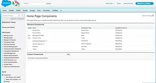

1) From Setup, click Customize > Home > Home Page Components. Click Edit next to either Messages & Alerts or Custom Links; both components need review and are in the Standard Components related list.
Example of Home Page Components page: Screenshot 1

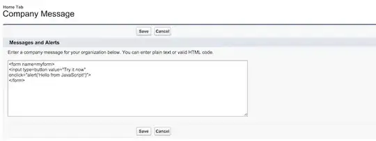

3) If HTML code is present in the text, use the browser search capabilities to search the text block for offending content with a <script> or other methods, such as onclick(). If you find any offending content, either you will need to remove it or replace the entire component with a Visualforce component.
Example of Message & Alerts page with offending content: Screenshot 2
