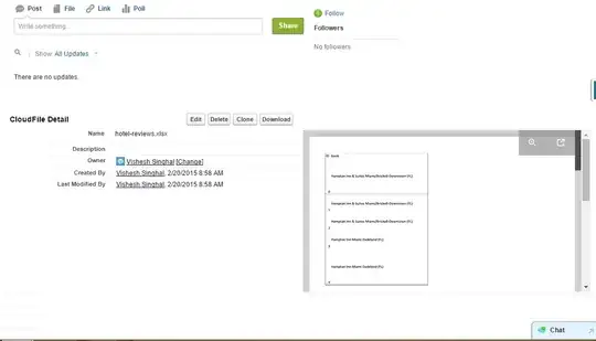

Please see the page layout below:

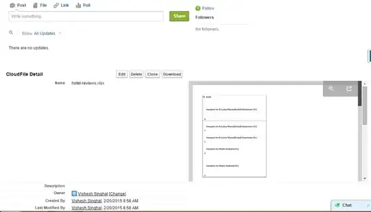

I want it to be the following:
Here, the box shown in the right is a inline visualforce page. is there a way to create the desired page layout?

No, this is not possible using the standard page layout features, because there is no equivalent to the HTML rowspan attribute. Therefore the cell blows the height of the entire row up. And without question it looks ugly...
If acceptable, I would recommend to use a different section in the layout which has only one column where you embed just your inline vf-page. This one-columns-section can be surrounded by two-column sections (above and below) which hold you regular fields. You can hide the captions of these sections to make them nearly invisible.
