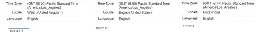

Output is always MM/DD/YY, when I'd expect it to be DD/MM/YY for European user locale's. The java message format documentation gives the impression that this considers locale, but I'm guessing SFDC is not passing it to the message format class. Hopefully there is a better way to attack this.

  • This is exact same scenario as : http://salesforce.stackexchange.com/questions/476/visualforce-locale-specific-date-format. In case you are using a outputtext can you not use .format() on {!datevariable} – Rao Jan 08 '13 at 19:01
  • @rao thanks for the link, shame on me for not seeing that one already ;) – Ralph Callaway Jan 10 '13 at 02:11
  • @rao, d'oh the other question implies this should work even though it doesn't – Ralph Callaway Jan 10 '13 at 02:35
  • Ralph I think the way the post suggests is lil different. You are using a string to get the param value, but the post uses sobject.field_name. Are u pulling in a field from the standardcontroller to display as output text, if so can u try something like opportunity.name and see if it works ? – Rao Jan 10 '13 at 17:58
  • @rao, I'm not sure I follow about using the string to get the param value, added a controller to clarify. – Ralph Callaway Jan 11 '13 at 00:25
