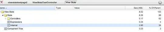

    Great question! One of the aspects that can really slow VF down is Viewstate. Particully if you are using lots of VF components in tables, not only can your own view state grow, but also what is known as 'internal viewstate'. Have you enabled the Viewstate option on your User (requires Developer Mode) to inspect the size of your viewstate? You will then find a Viewstate tab appears at the bottom of the page once your page has finished loading. – Andrew Fawcett Dec 17 '12 at 15:10

  • Thanks Andrew for sharing this. I will check it out right now. I just found out that my component is using up 55 KB of ViewState and 45 KB are Internal. So nothing I can do about it?! – Robert Sösemann Dec 17 '12 at 15:54
  • Yes and no, there is a link with the complexity of your page, take a look at the answer for the other question I linked to. Also keep in mind that even if its VF output components, they still carry an overhead. So if you can use regular HTML tags for output use those. – Andrew Fawcett Dec 17 '12 at 16:27
  • Regarding System.debug lines being stripped, you can force them to have a higher log severity by passing a LoggingLevel enum as the first argument. E.g. System.debug(LoggingLevel.Error,'A log message that won't get bumped off'); – ca_peterson Dec 17 '12 at 18:00
Other Tools. Your tools list is a good one, as is your question! In addition I would recommend you take a look at the Viewstate contents via the 'Show Viewstate in Developer Mode' setting on your user. This enables the following view on your page. Note that you can use 'transient' to control this for information you define in your controller that is essentially request scope only (not needed to be retained next time round). The research done here also proves that overuse of VF components, especially in large list rendering scenarios can cause the 'internal' view state to grow, so watch out for this as well.

  • Andrew: From reading you other research post, I just commented out checkboxes, converted apex:inputXXX to outputXXX but did not see a significant decrease in ViewState. Before I proceed switching Actions to AJAX I will try to strip down the markup. – Robert Sösemann Dec 17 '12 at 16:12
  • Oddly even the standard VF output components also consume internal view state. If you don't need the formatting capabilities (or can do it in Apex) just output via raw HTML tags to be sure. What is your viewstate size btw, have you got much from the View State debugger i mentioned above? – Andrew Fawcett Dec 17 '12 at 16:14
