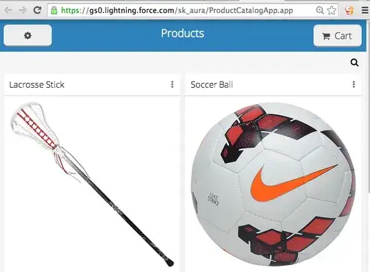

Lightning Applications are intended to be top-level, standalone entry points to distinct "apps". For example, Salesforce1 is a Lightning Application. Its Namespace Prefix is "one", and the App is called "one", thus it is available at /one/one.app , but Lightning Apps that you create can be accessed via the syntax /MY_NAMESPACE/MY_APP_NAME.app, e.g. in one of our orgs, our "Product Catalog" app is accessible via /sk_aura/ProductCatalogApp.app , and it looks something like this:

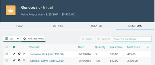

  • Override / extend portions of the Salesforce1 standard UI, via the "UI Plugins" framework. The UI Plugins framework exposes "Extension Points" where Lightning Components can be plugged-in to the standard UI. For instance, if your LC implements the force:recordTab interface, it can be added as an additional Tab / Slide within the SF1 record detail view by creating a new UiPlugin record from the Developer Console. It could look something like this:
