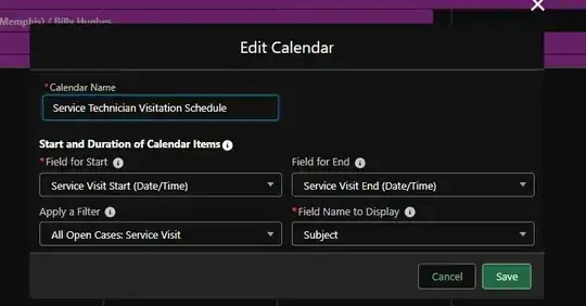

I am trying to programmatically create and distribute a calendar to all of my users with these settings: object calendar lightning experience
Here is the code I am using:

From what I can understand the error message is saying that it can't run the "insert calendarViews" command because of something wrong with the ID? I am getting the ID from the sample code in the documentation and I am not modifying it at all. Could that be my issue?
