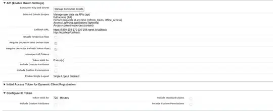

I am completely new to Salesforce and its integration via REST API. I am writing a NodeJS server app to fetch and sync accounts and contacts data. I have configured my connected app with the following settings to get the refresh and access tokens (I need these to fetch account and contacts data via API) through the web server workflow of Salesforce. I have selected these OAuth scopes based on this link

In your initial request, you do:
    scope: encodeURI(`refresh_token`)
Which means your effective scope is id,refresh_token. To get all the scopes you need, don't include this parameter, or make sure you specify all the scopes you need, such as:
scope: 'refresh_token,full'
I don't think you need to encode the URI parameter, either, should work fine without encoding (but, it shouldn't hurt, either).
