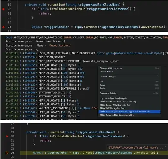

  • I tried RePlay debugger in VS Code. Can we check our own debug log without any existing log file? I tried using a log file to check all execution of line by line. – Virendra Oct 11 '20 at 22:12

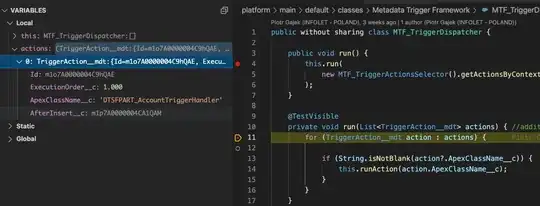

Just in case there weren't already enough "log replay debuggers" out there, I wrote another for vscode (dependant on mavensmate).
It's still pretty much in alpha, but is stable enough that you can set breakpoints and step through your code with decent variable inspection.

Apex Replay Debugger
  1. Set line breakpoints. Open a .cls or .trigger file and click the column to the left of the line numbers.
  2. Ctrl + Shift + P > SFDX: Turn On Apex Debug Log for Replay Debugger.
  3. Reproduce the issue or Execute Anonymous Apex.
  4. Ctrl + Shift + P > SFDX: Get Apex Debug Logs.
  5. Select your log from the list.
  6. Ctrl + Shift + P > Run SFDX: Launch Apex Replay Debugger with Current File.
  7. Code will stop on your breakpoints (point #1).

Apex Interactive Debugger
  1. Create Permission Set (e.g Debug Apex) with System Permission > Enable Debug Apex.
  2. Assign Debug Apex Permission Set to your user.
  3. In Visual Studio Code click the bug icon in the panel on the right side. Select Launch Apex Debugger from the picklist and click the green triangle to start.
  4. Set line breakpoints. Open a .cls or .trigger file and click the column to the left of the line numbers.
  5. Upload your checkpoints to your org Ctrl + Shift + P > SFDX: Update Checkpoints in Org.
  6. Reproduce the issue or execute the code.
  7. Code will be stopped on your breakpoints (point #5).
You can find more details here https://beyondthecloud.dev/blog/apex-debugging
