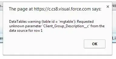

I am using datatable plugin in a visualfroce page. Below warning popsup only at the time of page loading and table looks good after closing the alert.
dattaable error
Here is the code...

  • Can you include your vf page code? – Jason Clark Apr 18 '14 at 16:44
  • Does the first row have a null value in it for the column Client_Group_Description__c? I've seen similar errors and it usually had to do with bad data in the column(s) which caused a problem when the plugin serialized the data and stored it in its internal structures. – Mark Pond Apr 18 '14 at 16:47
  • @MarkPond First row has values for all columns but not every row has. – vraavi Apr 18 '14 at 17:15
Sounds like your JSON data does not include the Client_Group_Description__c field (in all cases).
  • Does your user have permission to see this field?
  • Can you confirm that the field is in your @RemoteAction response payload on all records returned in the list?
Update: per Josh Kaplan, Salesforce changed the behavior prior to Spring '13 of the JSON serializer to omit fields (properties) which have null values in them, but apparently this change in behavior was reverted back to including the properties which had null values in Spring '13.
If this is indeed still the case, the first option I can think of off the top of my head would be to return your own type rather than returning the sObject type, using an inner class on your controller.

  • i am testing as admin.I check log file not all objects in the payload has client_group_description__c field. – vraavi Apr 18 '14 at 18:59
  • It worked after adding the commented code.Thanks Mark. – vraavi Apr 18 '14 at 22:16

Another way to deal with this is at the client side where if a field that DataTable requires is missing you add it back in as a null:
} else {
    for (var i = 0; i < result.length; i++) {
        if (result[i].Client_Group_Description__c == undefined) {
            result[i].Client_Group_Description__c = null;
    $('#mgtable').dataTable().fnAddData(result);
