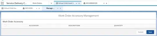

I have the scenario, on Asset I have related list of Work Order and On Work Order having related list Work Order Accessories.
If I am on Asset, select any Work Order, and trying to add Work Order Accessories, I am not able to get Work Order ID. I am using WorkspaceAPI to get the data, and developing Lighting component for Adding Work Order Accessories.

  • On Asset I have related List Work Order and if I select any work order, there I have Work Order Accessories related list, and this button is on Work Order. So, If I am creating directly from Work Order Object, it is working fine. But If I go to Asset, select any work order and then try to create the Work Order Accessory, then I am not getting the work order Id. Here I am facing the issue. I have uploaded one more image where I have selected Asset, then Work order and on that I have Work Order Accessories related List.Here it is getting failed. – Anita Mehta Apr 14 '20 at 05:54

  • I am able to do with passing parameter in irl with "c__", which I was missing /lightning/cmp/c__SD_ManageWorkOrderAccessory?c__workOrderId={!SD_Work_Order__c.Id}, it is working now. Thanks Shailesh for the help. – Anita Mehta Apr 14 '20 at 08:22
