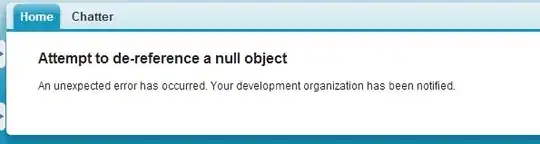

I'm having a problem that I think has something to do with recent version because I don't remember having this problem before. Basically, when I have an error in a Visualforce page, I don't see the error in the Debug Log. I get an email with the error description, but it sometimes takes a long time to send it, so it's not very useful for debugging.
Any clues why an error in a Visualforce page is not showing in the debug log?
Error message example:

There is an good trick to be able to see where the error null pointer occurs:
  • activate Development Mode in your profile
Without Development mode the system shows only the error message:
But if you activate the Development mode it shows the place in code where the error occurs:

Salesforce VF pages will not create a log. It's the controller themselves that create a log file.
This is letting your know you are trying to access and object's fields and your object is null.
IE an Sobject such as Opportunity and if the opportunity instance is null, when you try to access Opportunity.Name on the VF page it will throw you this exception. Same thing can be said for custom objects / wrappers. Maybe you aren't initializing your objects correctly prior to requesting the information on your page?
Depending on how complex your visualforce page is, I would recommend either doing a system debug on your apex class each time you request information from your controller / extension, or just commenting out your page and enabling sections of it to figure out what getter is causing you this issue.
