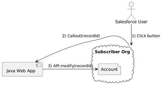

I am going to build a native Salesforce app (Managed package) that will be installed in many subscriber orgs.
The app will make callouts (eg. calling REST endpoint) to external Java app. The Java app will then use Standard Salesforce APIs (SOAP or REST) to modify Accounts records on behalf of the user in the subscriber org.
What is the recommended way to do this? It needs to be:
  • secure: Respect the Salesforce permissions of the user. Not use "single point of failure" integration user for the API access back to Salesforce. It needs to pass Security Review without any doubt ;-)

    Will the callouts and record edits only happen while the user is using Salesforce interactively? – Thomas Taylor Jun 27 '19 at 14:45
    Send user's encrypted SessionId in rest callout to the java app? – Pranay Jaiswal Jun 27 '19 at 15:40
  • @ThomasTaylor yes – Robert Sösemann Jun 27 '19 at 15:56
    Why not have the external Java Web App return the detail of the update it would like to make and have the Apex actually do the update. That way it runs in the same user's context and you can therefore apply relevant permissions.Your Java can return multiple different types of object to be updated. You can do a single Database.update with a heterogeneous list of objects (it's just upsert that can't handle this IIRC). – Phil W Jun 27 '19 at 16:23
