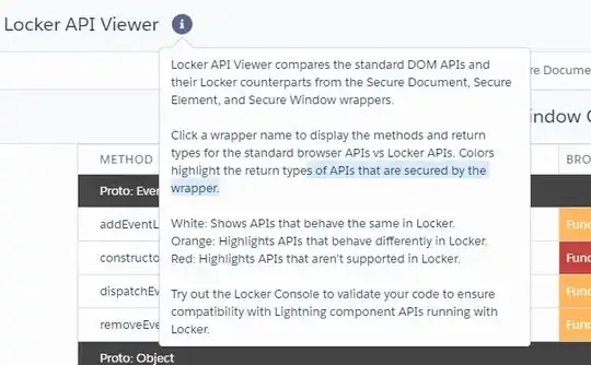

I don't see any issues using window.open(). According to Locker API Viewer open is supported.
I have a lightning component that leverages LDS sitting in lighting experience that opens a tableau external report using this method.
Reference: Leveraging Lightning Data Service in Lightning Framework
NOTE: This is my own blog post but the similar code is used for the tableau report!
Based On Comments: Colors highlight the return types of APIs that are secured by the wrapper.
