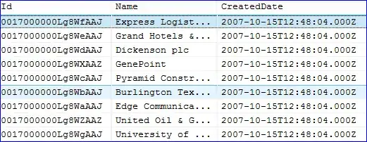

Would the following queries return the same sequence of items?
No / not always.
  1. Tim's answer.
  2. Records inserted in 1 batch might end up with same timestamp so order by creation date could theoretically sort them randomly within same group:
    SELECT Id, Name, CreatedDate
    FROM Account
    ORDER BY CreatedDate ASC
    (this might not be completely true, maybe SF stores the values with miliseconds in the underlying Oracle DB and they're just always returned to us with "000"... but then counting on such behaviour could backfire anytime they decide to change something)
