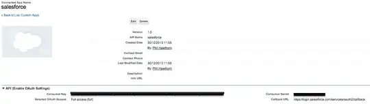

You may find you need to refactor your code to do the callouts etc. but you can use the OAuth Username-Password flow as described here to obtain a Session ID.
First, you must setup a Connected App (Develop->Remote Access->Connected Apps) which will give you the client_id and client_secret.
Connected App

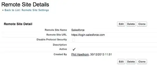

You must also create a Remote Site to allow you callout access to https://login.salesforce.com.
Then, the code is fairly simple (replace values between [] with real values):
