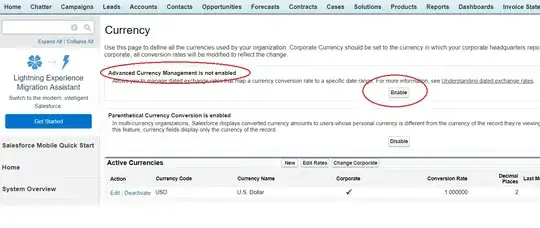

Is there a way to find if the Advanced Currency Managementenabled using api or apex or soql?
I have able to check if the multi-currency is enabled by using the api endpoint /services/data/v40.0/connect/organization but could not able to find how to find if ACM is enabled, is that possible?
