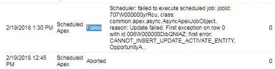

I wanted to double check on my scheduler to make sure is was compiled correctly. I need it to run every minute, which is not possible, so I have it scheduled for every 15 minutes. Testing is difficult because I have to wait 15 minutes every time I want to test one change. Is there a way around this?
While I am waiting for the newest change I wanted to check with you guys to see if everything looked okay. I am getting failed Status Details but because the limit is 255 characters, I am unable to see the entire failure string. So I am trying to troubleshoot (slowly...every 15 minutes. sadface). Also, why is it skipping scheduled job 1?

Your first job is set to run on the zero minute of the hour, which is exactly what your screenshot shows it doing. If you schedule it when you're already past the zero minute, Salesforce does not run it immediately. (That behavior is not analogous to time-based workflow rules).
As far as testing goes, you absolutely can test scheduled jobs in an Apex unit test by scheduling the job between Test.startTest() and Test.stopTest(). This will force the job to run synchronously.
Additionally, since you've wisely broken your logic out into a handler class, you can unit test the handler class separately to determine why you're getting errors. Unit testing will also generate logs you can inspect to view error details.

    I appreciate your feedback on the initial question. I know this got a little off topic so I apologize for bringing in all of the extra complexities. As of now, this is super helpful, I will be able to debug synchronously! – Olivia Feb 20 '18 at 19:11
