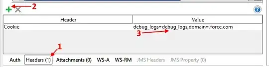

  • I don't believe I am authenticating with either. I am just hitting an endpoint and resource (see picture). – Olivia Jan 09 '18 at 22:59
Based on the comments that you aren't providing any Session ID or Access Token as part of the POST request from SOAP UI I'm assuming you are using an Apex web service that is hosted on a public site.
As such, until Spring '18 is released, you will need to include a cookie in the request to activate logging.
Use the cookie format defined in Set a Browser Cookie to Enable Debug Logging for Guest Users and the SOAP UI Request header functionality at the bottom of the request window.
Setting a request Cookie in SOAP UI
