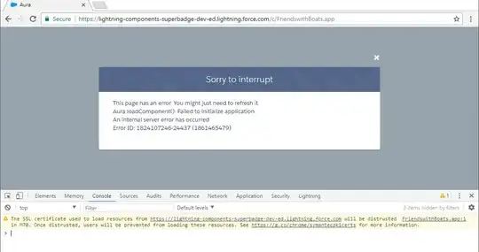

When I include my custom component (.cmp) inside of a standalone lightning app page (.app), I get a generic error:
This page has an error. You might just need to refresh it. Aura.loadComponent(): Failed to initialize application. An internal server error has occurred Error ID: 1165864723-88707 (1861465479)
To find out more details about what is causing the issue, I have:
  1. Enabled debug mode so that I get un-minified js code.
  2. Disabled caching
  3. Installed Lightning Inspector for Chrome
When I load the page, I do not see errors in the Google Dev Tools console or Lightning console. I'm lost as far as how to find out details about the error...

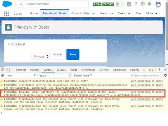

  • Adding a component to an App page through App Builder does not generate this error. Instead, when you open an app page in a tab, it generates a 'WARNING' in the Google Chrome Development Console. Is this a bug or by design? enter image description here
