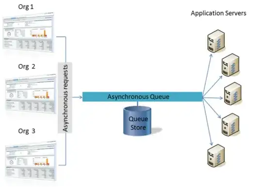

Salesforce uses an asynchronous queue to manage asynchronous requests from multiple organizations within each instance. Here's an example to show what it looks like:
Asynchronous Queue
Notice that the queue contains requests from multiple organizations. Each request can be associated with a job that could vary in complexity and running time. In the diagram, longer running jobs are represented with larger boxes.
As one request is completed, another request is removed from the queue and processed. Error handling and failure recovery is built in (via request persistence) so the requests are not lost if a queue failure or handler failure occurs.

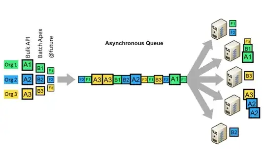

Here's how it looks graphically:

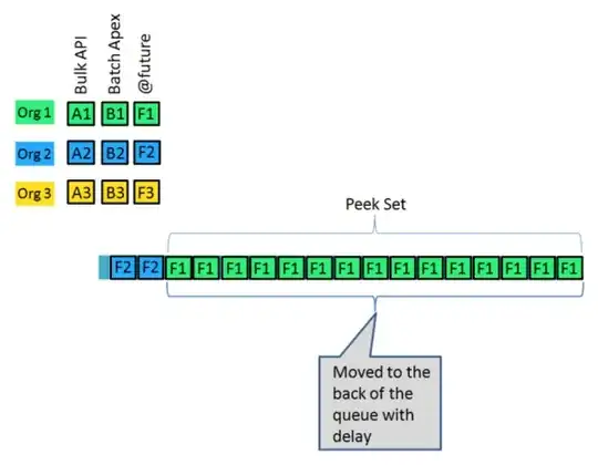

What happens when requests for a particular organization occupy the entire peek set when the queue is scanned in step 3 above?
This time, organization 1 has 15 requests remaining in the queue and organization 2 has two requests in the queue as shown in this diagram:
Extended delay
Since all of the requests in the peek set are from a single organization (organization 1), those 15 requests will be moved to the back of the queue with a specific delay. This is called an extended delay.
The delay is different for each message. For example, for @future requests, the delay is 5 minutes. That means a minimum of 5 minutes must elapse before those requests are eligible for processing.
When delayed requests become eligible for processing, it's possible for these requests to be acted upon by flow control and again get moved to the back of the queue and delayed.
