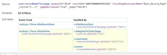

I just created a new custom object, and created a handler component with your code above. Hitting the standard edit action, and then hitting save, I have one "HANDLER" in my javascript console, and the Lightning Inspector plugin only shows one force:refreshView being fired.
I would recommend recording your interaction in the Inspector plugin and viewing the event log to identify when and what components specifically are firing the event. I suspect something more complicated is going on that a simple record save.
Inspector Screenshot
Additional reading on how to use the events inspector can be found here: https://developer.salesforce.com/docs/atlas.en-us.lightning.meta/lightning/inspector_events.htm.
