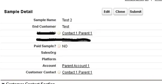

EDIT : Snip for how record shows up now after save and how I need.
NOW
Required
Ruchi
  • 1,515
  • 36
  • what do you mean standard page? the salesforce page showing the recently saved record? – Micz Domz Oct 14 '16 at 08:27
  • @MiczDomz Yes. Upon save it should return back to the current record page. As of now the current record upon save is showing in the V.F page. But I want to show it in the standard page. – Ruchi Oct 14 '16 at 08:30
