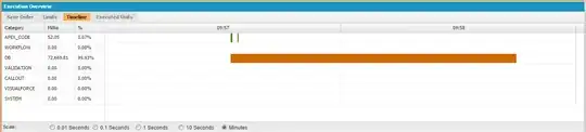

We're experiencing a very annoying issue with a Batch job processing "Large Data Volume" (1.5M records over a table containing 4.5M records). Our batch start method last statement is: return Database.getQueryLocator(soql); and despite the query completes successfully returning 1.5M rows, the batch doesn't kick off and a CPU timeout error is reported.
I believe the CPU timeout is not to be attributed to any of our logic, being the query our last code statement and completing it successfully (look at the pseudo-code, debug log and screenshots of CPU timeline and Apex Jobs provided below). I have the strong suspect the issue is related to the "housekeeping" sfdcfox mentions in here - but that's just a weak suspect as if that'd be the case I suppose I wouldn't be the only one experiencing the issue.
We have optimized the SOQL so that only the Id field of targeted records is selected: the SOQL doesn't contain any child/sub-query, and the records returned by the SOQL are as lightweight as they can be being only their ID field selected. This is a known factor that affects badly batch start() methods with CPU timeouts, but it's not to be considered by us after optimization. I wonder then if there are others.
The question (and bounty) is out for a clear, documented, detailed answer to the question: what are factors that can affect/impact on the post-processing that SFDC does on the recordset which is returned by a batch start() method, other than the presence of child queries or parent records?

Screenshot of Execution Timeline
timeline from dev console
LAST UPDATE
Changed the batch query removing all the WHERE criterias. The behavior of the CPU timeout changed - now it is happening 10 minutes after the SOQL failure (as the linked sfdcfox post suggests) instead of 2-3 minutes as per my previous debug logs. The table contains 3.5M records now.

  • @Eric tried that and... now the CPU timeout is happening 10 minutes after the SOQL has completed (not 2-3 minutes like in my previously posted debug/screenshots). 3.5M total records (table size changed as customer tried to shrink/aggregate data to overcome the issue). Opened a new support case now. – MLucci Jun 20 '16 at 14:56

Reason for CPU time out (in my case) – SubQuery
I tried SOQL Query Plan and run same query in Developer console and workbench, but it was not timing out. Still, gave one shot to idea that I had and tried to remove subquery from start method and queried again in execute method. And voilla…. it worked. So, subquery in SOQL was causing CPU time limit error and it was not even able to enter in execute method. I got lost because there were no debug logs. Instead of spending time on actual issue, I spent lot of time to figure out why debug log is not showing up.
Lessons learned
If we are getting CPU time limit error (in my experience I have seen many), then avoid using sub-query, its costly and time consuming. Damn !!! I need to tell my colleagues of previous projects to check code for subquery, where they are getting CPU error. If batch apex error says “First error – some error” , that means error is in start method and don’t even try to hunt for execute method debug logs.

Had same issue, removing sub query from start method solved it for us.
