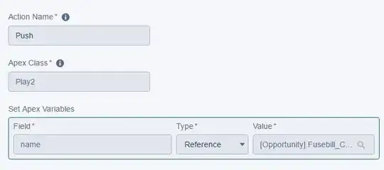

I am trying to execute a web service call to our backend system when the opportunity is closed/won. I am attempting to do a POST to our endpoint. All the api call is really carrying the account name and a few structural detail back (All listed below). My problem is that when the trigger executes I get the following error in the debug logs "System.CalloutException: You have uncommitted work pending. Please commit or rollback before calling out".
The Process Builder Passing in the company name: enter image description here

Apex can be annoying like that: limitations in termos of callouts and DML. What we've done to work around that is to make callout in the future method. Your invocable would call the future and pass the map. The future would construct the request and send it out. Your future should be annotated with @future(callout=true) to be able to make callouts.

  • Thanks...I guess then I would have to use a traditional trigger and can no longer use the process builder to execute the call. Makes sense! – Vik Apr 29 '16 at 19:56
  • Have you tried? I think you can use futures from inside an invocable method – mkorman Apr 29 '16 at 20:00
  • I'm trying to do the same - execute an invocable method which makes an HTTP Request; getting the same error. When I mark @future(callout=true) I get an error: Future methods cannot be marked as InvocableMethod. Is there a way around that? – zainogj Aug 19 '16 at 20:36
  • Found this article which explains it well. Make the invocable method a wrapper which calls the future method which makes the call out. – zainogj Aug 19 '16 at 20:52

@InvocableMethod makes the method visible to process builder.
@future(callout=true) makes the process builder able to use methods that callout since there can only be asyncronous callouts allowed from an invocable method.
public static void calloutmethod(List name){} - the @future callout needs to be in a separate method that is called by the @invocableMethod sendNotification(List name) since you cannot callout directly from a method annotated with the @invocableMethod.
