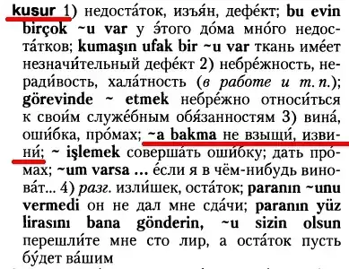

Here is what good Russian-Turkish dictionaries printed before 2015 write about kusura bakma.
Юсипова Р.Р., Турецко-русский словарь, Москва, Русский язык — Медиа, 2005. Около 80 000 слов и выражений. Страница 376:

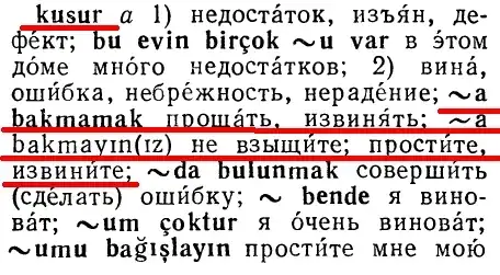

The next one is by a famous Soviet turkologist Nikolai Baskakov:
Баскаков Н.А., Турецко-русский словарь, Москва, Русский язык, 1977. 48 000 слов. Страница 576:

As you can see, both dictionaries translate the phrase as простите, извините, and also as не взыщите which I like the most, since the Turkish expression really does not contain Turkish verbs for прощать or извинять. Не взыщите actually means the same, but it is constructed more like the Turkish phrase, with a negation, and it can be roughly translated as "don't make me pay [for it]; don't prosecute [me], do not hold it against me".
Взыскать on Wiktionary.
