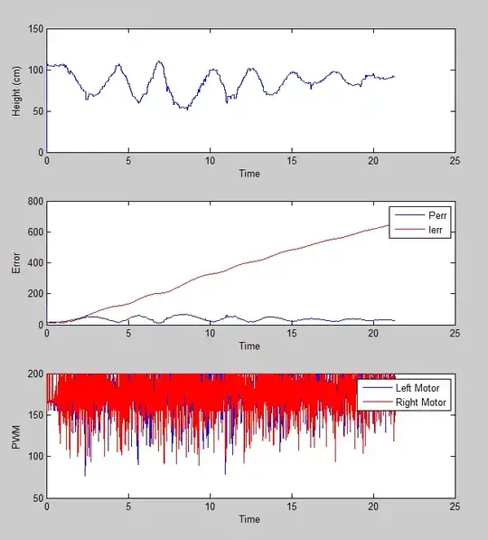

Resulting Response
Without Yaw Control, the plot below shows the response of the quadrotor. enter image description here
With Yaw Control, the plot below shows the response of the quadrotor. enter image description here

I found out that each of the outputs from each PID's give a too high of a value such that when summed together goes way over the PWM limit of 205 or Full Throttle.
  1. Without yawPID contribution The limiter kicks in without damaging the desired response of the system thus is still able to fly albeit with oscillatory motion along the z axis or height enter image description here enter image description here
    1. With yawPID contribution The added yaw components increases the sum of the PID's way above the limit thus the limiter compesates the excess too much resulting in an over all lower PWM output for all motors thus the quad never leaves the ground. enter image description here enter image description here

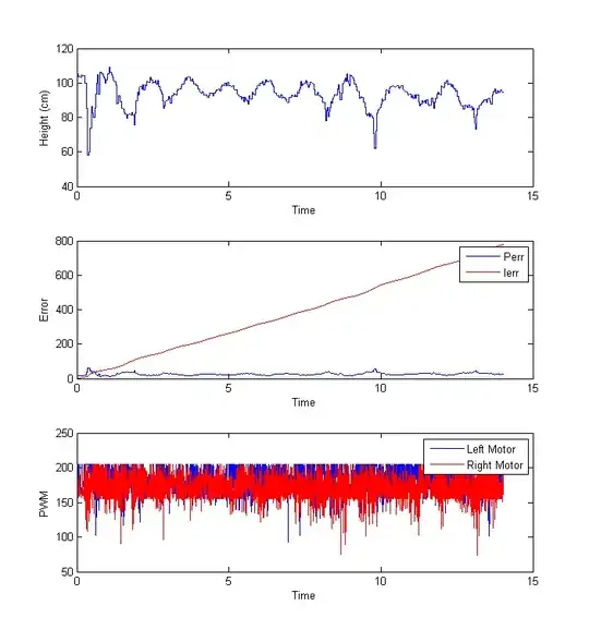

I have added the plots of the response when the control loop is fast (500Hz) and Slow (300Hz)
500Hz: Does not fly enter image description here
300Hz: Flies enter image description here

  • I'm no expert at this. There's not much between 160 min value and 200 max. In either case, you are constantly hitting the limit as I see it in your diagram. The more often you limit the controller value, the more it is actually limiter acting as a (nonlinear!) controller and not the controller itself. A limiter should kick in occasionally and not all the time. Strap a belt tightly around your breast and run a marathon. I'd try to use stronger motors so that your controller has enough air to do its job and not hit the limit so often. Only then try to control multiple variables. – Bending Unit 22 Apr 15 '16 at 12:45

There's not much between 160 min value and 200 max. In either case (with or without the yaw controller), you are constantly hitting the limit as I see it in your diagram. The more often you limit the controller value, the more it is actually the limiter acting as a (nonlinear!) controller and not the controller itself. A limiter should kick in occasionally and not all the time.
This is mostly based on how clearly the limit cuts down the PWM:
limited PWM
hence the following analogy came to my mind:
And I concluded that:
A stronger motor would not have run at full power and would not hit the limit so often. Hitting the limit is not bad in of itself. Imagine your PWM would be either at the upper or the lower limit. You'd have a (nonlinear) bang-bang controller. Such a controller isn't bad in of itself either, but it somewhat overrides the PID controller.
It can happen that you can manipulate the PID parameters at will and nothing changes. One reason for that can be a limit that makes your changes irrelevant. New parameters might change the output from 260 to 280 or to 220, which will have to effect if they are all going to be limited to 200. This is why constantly hitting the limit can be a bad thing.
With the yaw part, the phenomenon seems to be more pronounced, but not by much. I guess this is something to be aware of especially when summing up controller values, but not the actual problem.
Anyway, from the given diagrams I cannot tell why one would fly and the other would not.
500Hz -> 300Hz
Then another attempt was made and again one configuration works and the other does not.
I have tried to run the control loop at a slower rate and noticed that there is a drastic change in each of the PID components such that it is not exceeding the limit too much and now its flying again.
I tried to find differences between both diagrams. You are right, the limit is not exceeded as often as before in the flying operation. But what else is different?
May I ask what happens to the P gain contribution to the output if the speed of the control loop is decreased (dT increased). Does it have any significant effect like on the I and D gain which is time dependent (D decreases I increases)
Now I had a look at the separate controller error values. I combined them into the following image for comparison:
error values
The first thing that I notice is that there's a steady state error and thus $I_{error}$ constantly grows aka the red is the integral of blue and blue is bigger than zero all the time. This is not a good thing.
If there's a steady state error that the P gain cannot compensate, the integral part should grow and compensate the constant offset error.
The integral part should converge to some value. At least if it's compensating for a constant offset. I don't know what integral error from what controller this is, but an error that keeps growing is undesirable.
But maybe there is something inherently different between fly and nofly? The diagrams are a little hard to read because the axis are of different scale.
I tried to scale the images in gimp to fit and this is the result:
flynoflynofly
The pixelated plots are those two when it did not fly. Their overall $P_{error}$ is bigger and thus the $I_{error}$ is steeper.
But I don't think this is the problem. Look at the difference between the two $I_{error}$ of the cases when it flew. (the non-pixelated ones)
I'd say there's no other significant difference between the two cases.
conclusion
There's a constant error in the system. The controller cannot reduce that error. It looks as if the control loop is not closed properly.
Take a step back. Even in your first image, the height value oscillates and $I_{error}$ increases constantly. Inspect what's going on there.
Then create the angle controller separately. Put the quadcopter onto a pivot point or pole and see if it can maintain its angle. The height controller should be turned off.
When both controllers work on their own, try to combine both controllers in a weighted sum. $PID_{total} = 0.5 PID_{yaw} + 0.5PID_{height}$ Change the ratio as you see fit.
