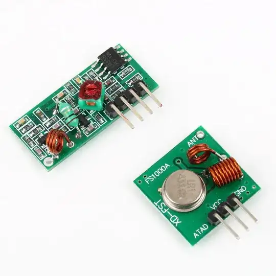

Also, other frequencies used, in addition to 2.4, 900, 868 MHz, are the 315 and 433 MHz bands:
433MHz Receiver/Transmitter

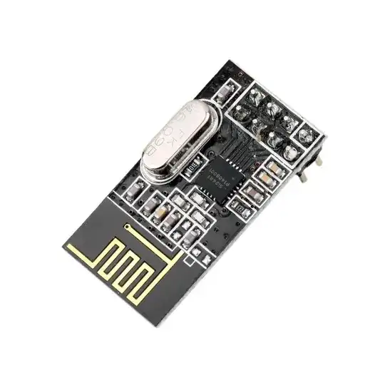

If you do decide to stick with 2.4 GHz then it is well worth considering the successors to the popular nRF24L01:
This product is not recommended for new designs. Nordic recommends its drop-in compatible nRF24L01+ or for a System-on-Chip solution the Nordic nRF24LE1 or nRF24LU1+.
nRF24L01
