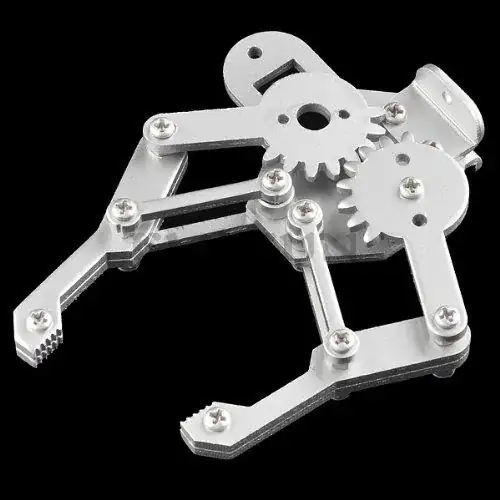

As the first photo (of the robot arm showed), a simple robot grabber/gripper is also available for the end of the arm:
Aluminium gripper
These grippers, and the brackets themselves, are widely available on eBay. Note that it is invariably cheaper to buy the brackets independently, than the whole arm kits that you see, by about 50% usually. Although having said that, the 21 DOF humanoid robot kits are actually the cheapest option, if you can get one for £45, and you think that you will need all of the extra brackets at some point in the future. You will also require bearings (and cups), so make sure that any kit that you buy has those included.
