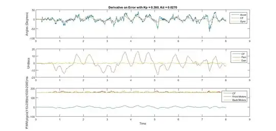

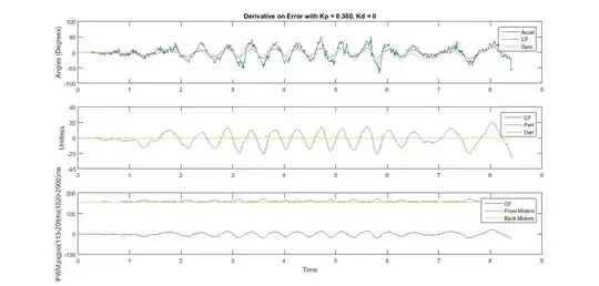

I am currently implementing a single loop PID controller using angle setpoints as inputs. I was trying out a different approach for the D part of the PID controller.
What bought this about is that when I was able to reach a 200Hz (0.00419ms) loop rate, when adding a D gain, the quadcopter seems to dampen the movements in a non continous manner. This was not the case when my algorithm was running at around 10Hz. At an angle set point of 0 degrees, I would try to push it to one side by 5 degrees then the quad would try to stay rock solid by resisting the movements but lets go after while enabling me to get it of by 2 degrees (the dampening effect weakens over time) then tries to dampen the motion again.

Here's my data:
Derivative on Error without D gain
Derivative on Error with D gain
Derivative on Measurement with D gain

All PID controllers act on an error signal, so you definitely should stick with your first implementation. The derivative term in the PID controller wants to "see" how the error is changing - if the error is getting bigger, then the derivative term gets larger and "kicks in" a higher contribution. If the error is getting smaller, then the derivative term backs off.
Your problem description is vague; something about "pushing" the quadcopter and damping and feeling something.
Engineers don't have feelings, they have data.
For the moment, with no data, all I can tell you is to reuse your first implementation and double check how you are acquiring your deltaTime2 information. Typically, in industrial controls, the derivative term is left off of the controller and only a PI controller is implemented. This is because any bit of temporal sampling problems (not taking the sample on time or mis-judging the sampling rate) can cause huge problems with the derivative term.
Imagine your sampling rate is supposed to be 0.005 seconds (200Hz). If instead of that sampling rate, you mis-judged the sample rate to be 0.006 seconds for one sample, then the following happens:
  1. No change to proportional error because it doesn't interact with the sampling rate.
  2. Integral error multiplies proportional error by this sampling rate and then adds it to all of the previous integral error samples, so overall it's a pretty small impact.
  3. Derivative error divides proportional error by this sampling rate with no other means of context.
So, conceivably, you could have something like:
prevIntError = 1.8;
prevDerError = 1.1
PropError = 1;
IntError = prevIntError + 1*0.006;
derError = (1 - 1.1)/0.006;
So where the integral error is now 1.806 instead of 1.805 (an error of 0.05%), your derivative error is -16.6 instead of what it should be, (1 - 1.1)/0.005, which is -20. That means that error in the proportional error signal is 0, the error in the integral error signal is 0.05%, and the error in the derivative error signal is 17%!
As your sampling rate increases, your sampling period goes down. Errors in timing can begin to become significant after a point. For example, at 10Hz, you are sampling every 0.1s. If your timing accuracy is +/- 0.001s, then this means that your time sampling error is +/- 1%. If you push to 200Hz (0.005s), and your timing accuracy is still +/- 0.001s, then suddenly your time sampling error is +/- 20%!
So, in summary:
  1. Post data, not feelings.
  2. Revert to your first implementation.
  3. Check how you acquire deltaTime2 and report back.
Please update your question to include the answers to 1 and 3 (don't post it as a comment to this answer please).
