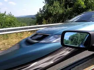

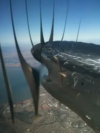

  • Global shutter basically means all pixels get captured at the same time, as opposed to Rolling shutter where they are captured sequentially in a line scan fashion. Since your UGV will be moving around and performing stereo algorithms over the images you capture, it could be important that you avoid aberrations that occure when camera move, such as the ones seen in the pictures below (taken from Wikipedia):
Moving car taken with CMOS camera phone exhibits skew A photo exhibiting partial exposure. Lighting conditions changed between the exposure of the top and bottom parts of the photo. A shot of a turboprop propeller
