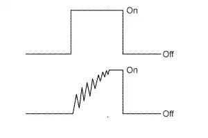

The only way I can explain that is that during a change of state, the signal received from the sensor is not really square, but somehow noisy.
Like in this image :
explanation?
Therefore we would have, indeed, many RISING on one change....
(However reading the output of the sensor on an analog pin shows a direct variation from 880(HIGH) to 22(LOW))

    This might be an effect called boucing. This is because switching a signal does not produce a perfect edge... It rather bounces a bit up and down. Anyway this is a common issue in electronics and there are plenty of solutions for this issue, including electronic approaches (like low-pass filter) and software approaches. – TobiasK Jan 20 '16 at 12:11

  • Basically you cannot solve this problem with an interrupt based approach (at least in the arduino world). Because to remove the bouncing from the signal you need a filter (in this case a digital one). Digital filters are based upon multiple samples of a signal collected with a specific time between those sample points. With the interrupt approach you got no influence on the sampling interval nor the amoumt of collected samples, therefore this approach wont lead to a good result. Anyway triggering on both edges is also useless... my bad. I recommend using electrical low pass filter. – TobiasK Jan 20 '16 at 21:16
Your signal actual going back and forth like that; it's registering with the microcontroller because you're at an intermediate voltage. As @TobiasK mentions, this is called "bouncing".
You're trying to use this for controlling tires, so I would suggest you do a little math to determine whether or not a "subsequent" signal could be considered valid or not.
Distance traveled is d = r*theta;, where r is the wheel radius and theta is the angular distance (in radians) the wheel rotated. Your encoder has some number of pulses per revolution (ppr), so, at top speed, you can expect some number of pulses per minute, or pulses per second. You can either determine this with the maximum wheel speed in RPM or in maximum vehicle speed in [distance]per minute.
Then, take the inverse of the maximum pulses per second to get the minimum seconds per pulse. Any pulse that you detect in a time period shorter than the minimum seconds per pulse is then invalid, so you can ignore it.

In thinking about this for a moment, I would actually caution you to double your pulses per second (halve the seconds per pulse) value because you're prone to bounce on the rising AND falling pulse, as your data above shows.
Ultimately you're going to have to do something to filter the noise (bounce) out of your signal. You can either do this in a fixed manner, with electronic components (RC filter) or you can do it in software. I would always recommend software whenever possible because it's so easy to update or modify if you find your parameters change down the line, such as upgrading to faster motors, etc.
