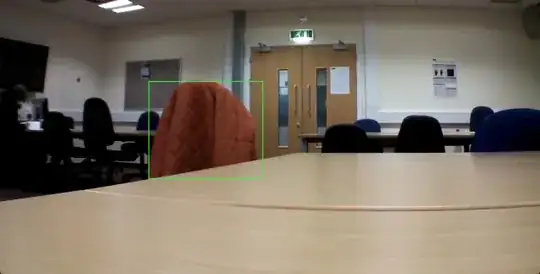

I have written an application which does simple image processing on the images obtained from the camera of the drone using OpenCV and finds needed contours of the object to be tracked. See the example below: enter image description here
Now the part I am struggling is finding the technique using which I should find the velocities to be sent to the move3D function. I have read that common way of doing controlling is by using PID controlling. However, I have read about that and could not get how it could be related to this problem.
To summarise, my question is how to move a robot towards an object detected in its camera? How to find coordinates of certain objects from the camera?
