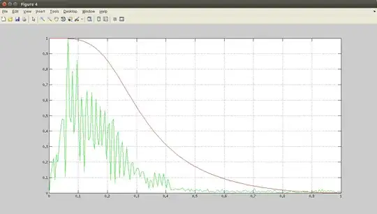

Below, the discrete Fourier transform of the signal in a normalized frequency scale and the second order ButterWorth low pass filter.
With this filter, the main components of the signal are preserved.
Although the undesired spikes are attenuated by a factor of three the plot shows a slight phase shift...

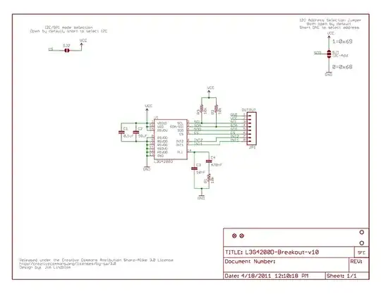

1./2. I am using a breakout board from Sparkfun. You can find the circuit with the Arduino and the gyro in this post: Can you roll with a L3G4200D gyroscope, Arduino and Matlab? I have added pullup resistors to the circuit. I would exclude this option because other sensors are connected via the i2c interface and they are working correctly. I haven't any decoupling capacitors installed near the integrated circuit of the gyro. The breakout board I'm using has them (0.1 uF). Please check the left side of the schematic below, maybe I am wrong.
