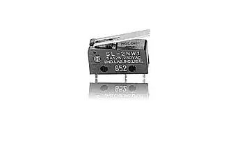

If you are running gears as wheels on gear tracks, I do not understand how weight could change the number of steps. How can they slip? If there is no slippage, then the amount of steps should always be sufficient, although as mark suggested, most real world solutions would also include a limiting touch switch in case of mechanical failure.
Since using number of steps involves some math, it may be just easier and as good to use only limiting touch switches. It is common to put touch switches at any location such as the middle. In the case for a middle switch, some protrusion on the tracks would trigger the switch on the robot.
typical switch
Touch Switch

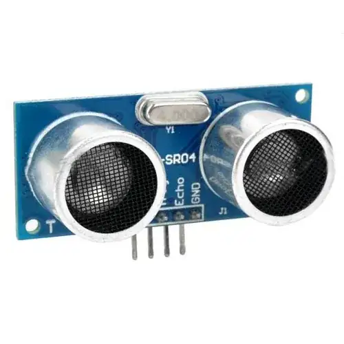

I would suggest you to check the HC-SR04 Ultrasonic Sensor that could easily wired and programmed into your robo vehicle. By adjusting the sensor to correctly emit ultrasound on a fixed object and measuring echo/ping from the object, you can judge the distance quite accurately. enter image description here Another option would be to lay encoder track(alternate black and white zebra-striped track, so you can use an optical eye -an LDR or LED opto sensor to count the contrast changes while traversing through the track). enter image description here (I am not so good with photoshop, HTH :) )
