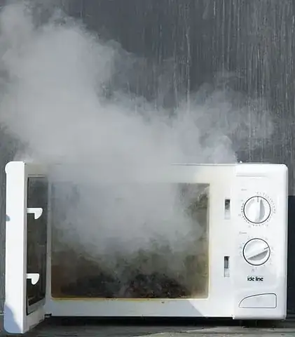

With this microwave, a lot of the control algorithm is on you. You cannot put different things into the oven, use the same settings and expect proper results. The frozen chicken and the rasins in the image will look different after 5 minutes at full power. You have to dial in the settings that work for the food you put into the oven.
