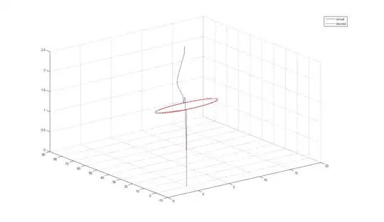

My desired trajectory is shown below
The results are
And the actual trajectory vs the desired one is
My code for this experiment is

The code of the desired trajectory is
clear all; clc;
fileID = fopen('xyTrajectory.txt','w');
 angle = -pi; radius = 5; z = 0; t = 0;
for i = 1:6000
    if ( z < 2 )
        z = z + 0.1;
        x = 0;
        y = 0;
    end
    if  ( z >= 2 )
        angle = angle + 0.1;
        angle = wrapToPi(angle);
        x = radius * cos(angle);
        y = radius * sin(angle);
        z = 2;
    end
    X(i) = x;
    Y(i) = y;
    Z(i) = z;
    fprintf(fileID,'%f \t %f \t %f\n',x, y, z); end
fclose(fileID); plot3(X,Y,Z) grid on
