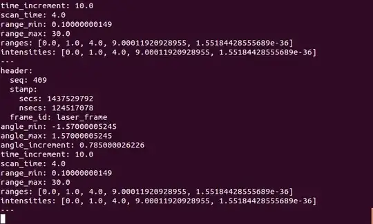

I upload your code (minus delay) to the arduino UNO (don't have an extra mega). I get a Low memory available, stability problems may occur. message. But you have a mega so you should be good.
But it runs good on the my UNO.
image description
Just in case it helps, I ran this launch file.

Then rostopic echo /LaserData

Comment by jseal on 2015-07-21:
I updated my answer, i don't know if it will help, but thought It would give you another data point.
