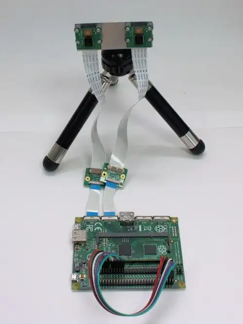

The raspberry Pi does not have 2 camera connections, but its brother, the Pi Compute board does.
http://makezine.com/2014/11/03/stereo-depth-perception-with-raspberry-pi/
