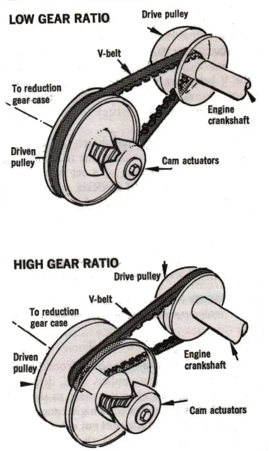

These types of low cost 2 speed transmission almost always are based on some gyroscopic effect on a simple gear train.
You are right, even knowing how they work, I could not find any described on the internet. Very surprising.
Look at this image; enter image description here
Imagine as the speed increases, the lower block will rise.
So now you have to imagine it attached to a shifting lever (or gears themselves).
Combine the 2 concepts and you have automatic 2 speed gear shifting.
In practicality, it is usually less costly to use infinitely variable transmissions for the same effect on anything of decent size / value.

  • Not totally sure if gyroscopic effect is entirely accurate, Conservation of Angular Momentum may be a more appropriate description. But I think you followed what I was saying. The faster it spins, the larger the diameter becomes, mechanically lifting the bottom ring in the process. – Spiked3 Jan 24 '15 at 08:17
  • Thank you. I now understand how the gyroscope moves the gear selector, and the concept in general. But only the first picture is clear to me. It's hard to see in the second picture how, when the shifter is moved (shifted), how a new gear is selected. Perhaps it's my inexperience with these kinds of diagrams, but I would think there should be a second location (a different configuration of gear sizes) that is sitting there unused, waiting for the gear to be shifted to. It seems like threre is only a single gear. – aliteralmind Jan 24 '15 at 16:31
  • You are right, that is not the best diagram in the world to show the idea. Indeed one gear on either shaft would be offset so that only one pair at a time is engaged. – Spiked3 Jan 24 '15 at 18:41
