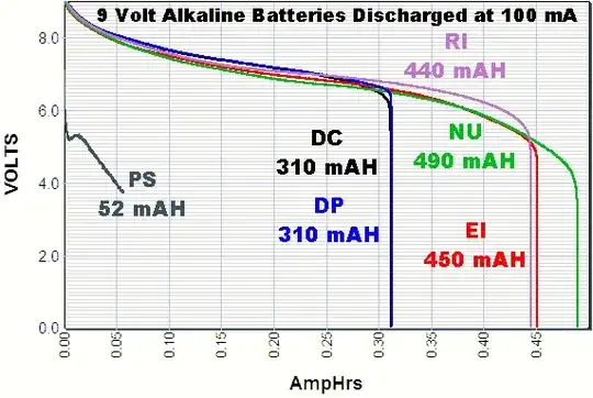

You'll need to pick a more appropriate battery for this robot. Have a look at the discharge curves for several batteries, and pick one that fits the current draw and desired operating time for your robot. Here's an example of what a discharge curve for several 9V batteries looks like:
Discharge curve
mAH is Milliamp-hours: how many hours the battery will supply a given amount of current -- a way of measuring capacity.
The other factor is how much current you draw:

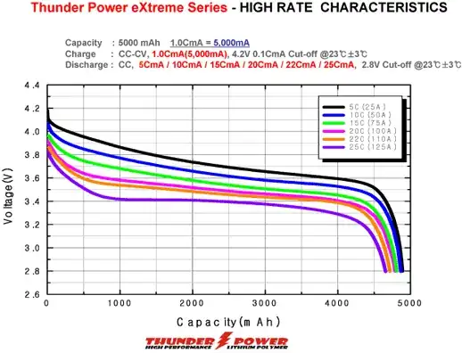

Discharge curve (source: rctoys.com)
The different curves indicate different loads for the battery. There is a maximum load for every battery, and you should not exceed it; best case, you get poor performance, worst case you get a fire or explosion. In this graph, you can see that the 125A load causes a severe drop in voltage. That's the same effect you're seeing -- a severe drop in performance caused by overloading the battery.
