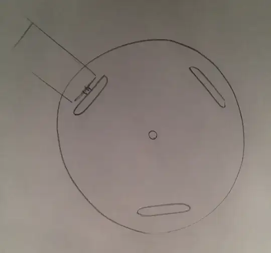

Why do you need to have the motor at the axis? Wouldn't it be much easier to have several at least one motors at the edge of the disc and the disc would lie on wheels (the smaller the more accurate)? There could still be a pivot in the middle but just with ball bearings instead of a motor. If the surfaces are clean this should be accurate and by far easier to build.
If this is incomprehensible I'll do a drawing.
[I'd have preferred for this to be a comment, but lack the reputation and wanted to be helpful]
EDIT: Here have crappy drawings; I hope they bring the general idea across though. It would be quite important to have a force pulling (or pressing if it is convenient to have something above the disc) the disc down so that you have more friction; then normal rubber wheels would be enough I think (with the benefit of having smooth motion). I'm not sure what you mean by skate bearings as wheels; the wheels should have friction in contact with the disc. The non-motorized wheels (to support the disc) could have ball bearings as hubs.
On a side note, the design you proposed in the question is quite likely to cause the disc to wobble even if there is a only a slight misalignment or vertical force on the disc.
It might also be advisable to mount all those things on a material that doesn't change volume too much based on temperature/humidity.
seen from above, the disc is transparent seen from the side, the non-motorized wheel is transparent
