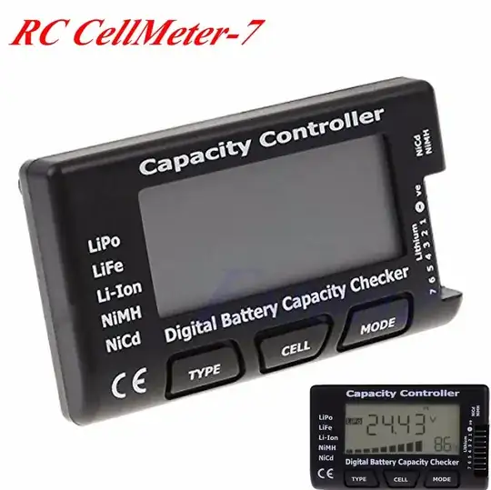

You can use an RC battery checker,
to verify the individual cells in a battery pack. These are cheap, for about $3.
If any cell is below 3V on a LiPo battery then it should be considered as dead, or dying, and hence, it should be replaced.
