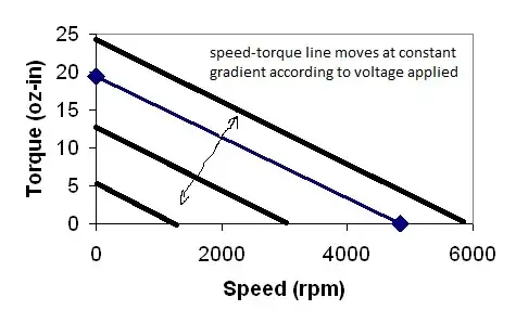

I understand that the gradient of the speed-torque curve is defined by the design of the motor, the exact position of the curve depending on the voltage applied. So if the voltage is changed the speed-torque curve is also changed but remains parallel to the initial curve before the voltage was changed. See figure below.
So my intuitive guess is that when using the motor at a given desired operation point (desired speed and desired torque), the corresponding speed-torque curve Cd has a gradient specified in the data sheet of the motor and passes through the operation point. This curve Cd is obtained at a corresponding voltage Vd. See diagram below.
So my next guess is that in order to have the motor operate at this desired operation point, you have to set the voltage applied to the motor to Vd, and apply a current Id (computed using the torque and the torque constant).

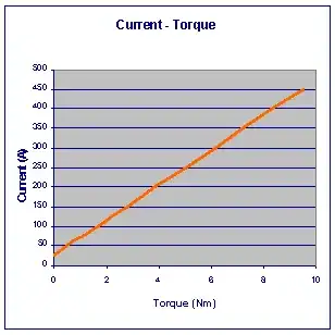

Before we get into what's happening in the motor controller, it would be worth looking at a different graph:
Motor current torque graph
Here we can see that the torque produced by the motor is purely a function of the current flowing through the windings, and it's pretty linear. If you want to produce a certain torque at the motor, all you need to do is look up on the graph for the current required, then tell your current controller to deliver this current. It does this by constantly measuring the actual current, and adjusting the voltage at the motor (using PWM magic).
