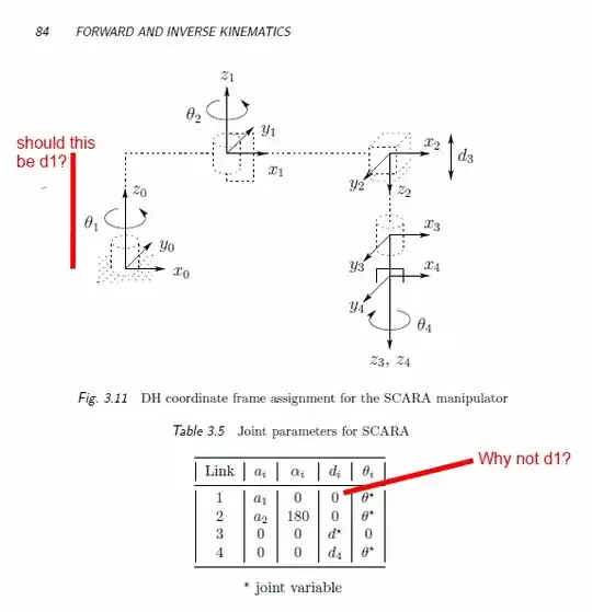

I'm going through the textbook Robot Modeling and Control, learning about the DH convention and working through some examples.
I have an issue with the following example. Given below is an image of the problem, and the link parameter table which I tried filling out myself. I got the same answers, except I believe there should be a parameter d1 representing the link offset between frames 1 and 2. This would be analogous to the d4 parameter.
If anyone could explain why I might be wrong, or confirm that I have it right, that would be great. I hate it when it's me against the textbook lol.
Cheers.

You are right he made a mistake there.
This is probably one of many typos in this preprint of Mark Spong. You should rather turn to other good books, such as the mathematically more elegant book of Richard Murray,Zexiang Li and Sankar Sastry, A Mathematical Introduction to Robotics Manipulation (MLS94). The mathematics they use is consistent in other of their books such as Yi Ma, etal An Invitation to 3D-Vision. screw theory and Lie group theory instead of Denavit and Hartenberg's minimal approach are used in the book. It is much more superior than the D-H approach, and is widely adopted in the academia (the industry is another story).

If the axes zi−1 and zi are parallel,A common method for choosing oi is to choose the normal that passes through oi−1 as the xi axis; oi is then the point at which this normal intersects zi. In this case, di would be equal to zero. Once xi is fixed, yi is determined, as usual by the right hand rule. Since the axes zi−1 and zi are parallel, i will be zero in this case.

There is no mistake here. The scara robot has 2 vertical Z-axis in wich it rotates. therefore There is no real translation in the Z-direction between j0 j1 and even j2.
that's why d1 and d2 are zero because there is no change of Z opposed to the previous joints.
If you would fix that mistake, you could move j0 up so it coincides with j1 and j2. and then add a j-1 and a new row at the top of the table for joint 0. then d0 is indeed needed. (distance between X-1 and X0 along Z.
You can either have $d_1 \neq 0$ or set $d_1=0$ and embed the vertical displacement in $d_3^*$.

I'm a Chinese college student and also find this problem when learning industral robot. If you clearly identify the motion of the SCARA robot, you'll find that the distance of each joint is stable, for example the distance of joint 1 and 2 is always the b1. So just review the definition of bi: the joint offect. I think you're correct. Please find the Page 110 5.17- from the book , written by SAHA. There is clear dipict of sturature about SCARA robot. Any commutation, welcome to e-mail me. sailong.wu@gmail.com
