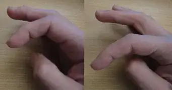

If you only place the IMUs on the fingertips, the data is insufficient to estimate pose. Remember that IMUs only measure attitude (also known as orientation) in space. Can you imagine cases where the fingertip may remain in the same orientation, yet the hand pose is different?
Hand pose
Observe that the index fingertip orientation does not change, however, the position (pose) has changed.
Therefore, you can see that IMU data on the fingertips is not enough to estimate pose. However, additional data can improve the estimate of hand pose, if you fuse the IMU data with your existing data using a Kalman filter.
It is theoretically possible for IMU data alone to be sufficient to estimate pose. However, this would require an IMU for each and every independently movable part of the hand. Since I cannot independently move the top two segments of each finger, we would only need 2 IMUs per finger (one on the fingertip, and one on the segment just after the knuckle, ie. segments 1 and 3 on the finger), plus 2 for the hand, and another for the end of the arm (to get the wrist motion). Therefore, you need a total of 13 IMUs to get all the data required.

  • Thanks ronalchn. You mentioned magnetometers. Wouldn't a 9-axis IMU (with magnetometer, like the MPU-9150 ) be able to detect the difference between the poses shown in your photos? – Rocketmagnet Nov 14 '12 at 09:31
  • if you only put the IMU on the fingertip, then only the position has changed (no change in attitude), as mentioned later, you would need an IMU on the segment just after the knuckle. I edited to clarify. – ronalchn Nov 14 '12 at 10:19
  • @Rocketmagnet, when I say the data from 13 IMUs only is sufficient, I should clarify that they need to include the magnetometers. – ronalchn Nov 14 '12 at 10:28
