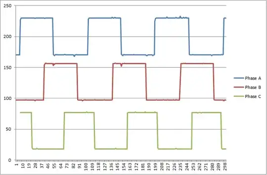

Update: I've measured the wave forms with my DSO quad and see the expected 120 degree separated signals (the measurement for phase C gets more inaccurate over time because I only had 2 probes, so I measured phases A & B first, then A & C, and then merged them.
When ESC speed is 0.1: speed = 0.1
When ESC speed is 0.3: speed = 0.3
Previously, I was using a hardware quadrature counter (EQEP module on a BeagleBone). At speed=0.3, this was counting backwards no matter if I do forward or reverse!
