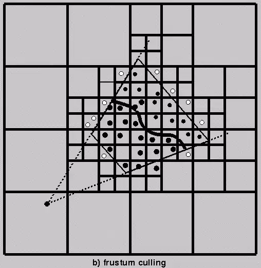

The term you are looking for is "frustrum", and the algorithm you want is "frustrum culling". frustrum culling
Check out this answer for how one would implement culling in a 2D game.
