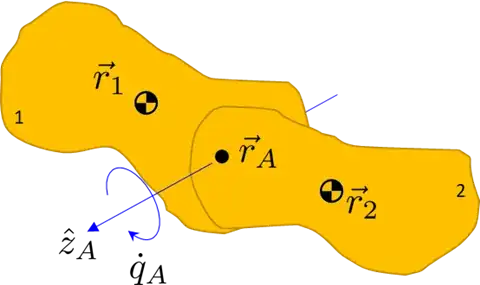

Consider the use case of two connected rigid bodies floating in space
fig1
Definitions
At some instant, in time the locations of each body's center of mass are described by the vectors $\vec{r}_1$ and $\vec{r}_2$. The velocities and accelerations are respectively $\vec{v}_1$ and $\vec{v}_2$ and $\vec{a}_1$ and $\vec{a}_2$ also at the center of mass. Rotationally they move with $\vec{\omega}_1$ and $\vec{\omega}_2$ and their accelerations are $\vec{\alpha}_1$ and $\vec{\alpha}_2$.
The mass properties of the two bodies are described by the scalar masses $m_1$ and $m_2$ and the mass moment of inertia tensors $\mathrm{I}_1$ and $\mathrm{I}_2$ summed at each center of mass but using the inertial frame basis vectors.
The revolute joint between the two bodies is located at $\vec{r}_A$ at this instant, and the relative rotation axis is $\hat{z}_A$ with joint speed $\dot{q}_A$. The joint motor has specified torque $\tau_A$.
