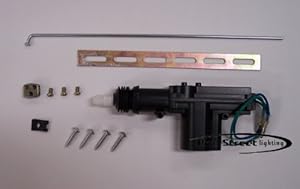

Car door lock actuator
Shares some of the properties from a RC Servo-motor, but has linear action like the solenoid, and don't have position feed-back (some have a open/closed feed-back). Needs a pulse of current to operate too, but needs reversing the current to reverse the direction of force.
Image from http://www.amazon.com/
